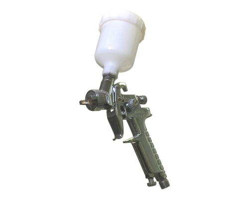

PostPosted: Sun Jan 08, 2006 7:22 pm
Here is the gun that I have, works very well spraying shellac and laquer (this is all I've sprayed so far).
This is a Canadian site with the specks on the gun. The cost is good too.
